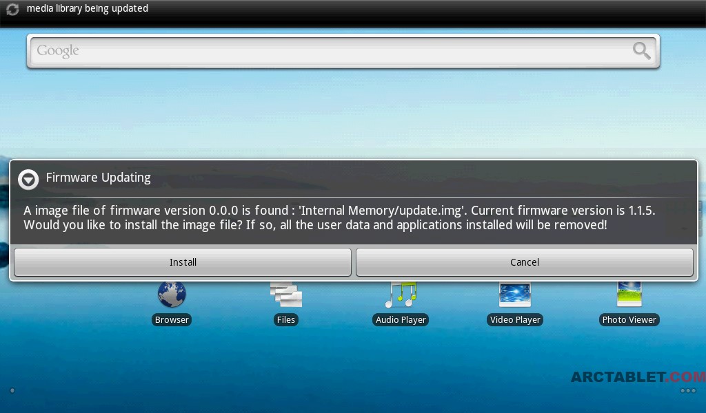

    Hier kannst du die CustomFirmware runterladen:Arnova 10b custom Android 2.2 (Froyo) firmware with Android Market and root – kasty-arn10b-22-01 | ARCTABLET NEWS
    [h=3]Firmware update procedure:[/h][h=4]Step 1 – Install firmware[/h]
    The first part of the procedure is similar to the one on the Arnova 10Connect your device to the electricity socket, fully charge it and leave the socket connected
    Unzip the update.img file out of the zip archive
    Copy the img file to the root of your device
    Unmount USB on your device, it should give a prompt similar to this one:
    Push the Install button and follow the update procedure
    You can also refer to our flashing procedure page for more details.
    The first boot after flashing may take some time (few minutes), please be patient.
